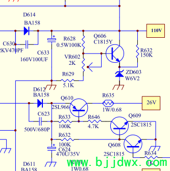

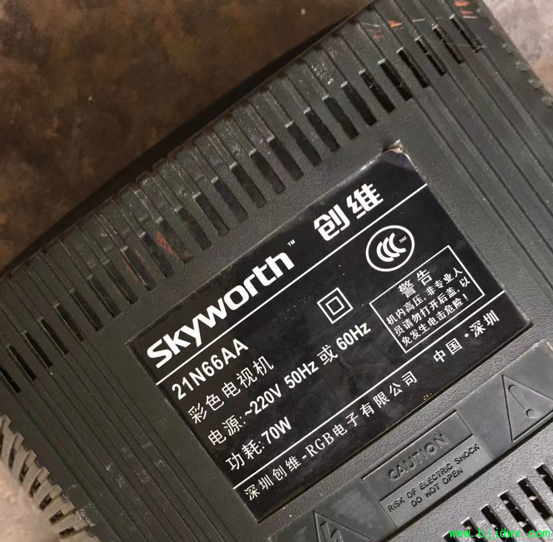

创维21N66AA红灯亮不开机,开壳查Q610的B极5伏多,E极26伏,C极1.8伏,不正常,换新开机图声正常
